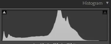

2. As presented in the OP the image is a solid stop underexposed. Underexposing and raising the exposure post will increase any noise, especially in the shadows. This is the original histogram

That was a lot of great information. Thank you for the detailed step by step! I need to learn to use the tone curves, i usually just use the sliders above. About the photo being a Stop underexposed, is there a sciente to measure this in Lightroom, or does it go by eye?

As to exposure the histogram is a visual representation of the data in your image. Additionally most cameras have the ability to display the histogram in view. Here's a link on using it in LR A Practical Guide to the Lightroom Histogram
