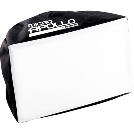

Thanks for the info. Yeah, I'm sure I had the soft box. I also put the flash power down to 1/2 which is why I'm so surprised as well. The softbox I used was a Westcott Micro Apollo
2200 Westcott Micro Apollo 8" Flat
I had the camera about 8' away from the subjects.

yea if you really want good light you need more than an on camera 'softened' speedlight.

True but you can get quite decent results with just one flash. You need to be as creative with the gear as you are with the image.
1/ If you can't bounce off the ceiling or the walls, make yourself a bounce card to attach to the flash.
2/ Get a couple sheets of foam core at the craft store. They make cheap reflectors. Want more reflection, cover one with aluminum paper.
3/ Get your subjects away from the background. The more distance between the two, the less shadow you will see.
4/ If that softbox doesn't soften the light enough drape a piece of sheer over the front. If that's not enough, add a second layer.
5/ Definitely try toget the flash off the camera and to one side. You will need a cord to go from the flash to the camera but they are not that expensive.
Be creative.
