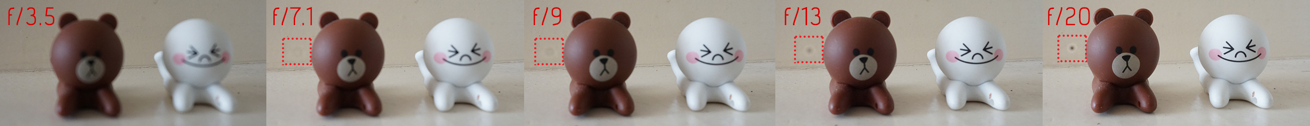

Hi! I'm really just a beginner in using cameras and got myself a mirrorless cam. I just knew things like mixing exposure in manual mode recently. While trying to test aperture, I noticed a small spot in my pictures. Is this alarming? I just purchased it a month ago so I'm really worried.
You can see a small spot appearing while f-stop decreases. Anyone, please help :) Thanks a lot!
You need to get your sensor cleaned

Are you guys sure it's on the sensor? Shouldn't the spot look the same regardless the f stop then? To me it would seem like it's on one of the elements of the lens.
No! Dust on the sensor would likely only be visible when stopped down. If it were the lens, it would be visible at any f stop
