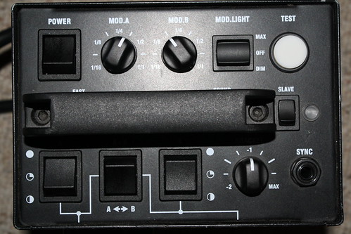

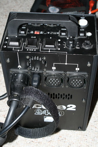

Im having a problem. I hook up everything , looks like im ready to shoot away. The flashes fires, the light fires but when I look at the Photo screen it's have if ONLY the flash fired and NOT the LIGHT. Why is this? Though i'd show everyone a few pics of my equipment. PLEASE HELP!:confused::confused: newbie!! also it is not my equipment.(except for the flash and camera.)

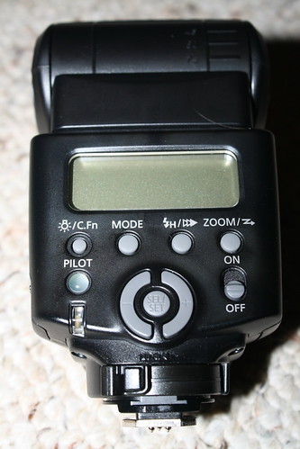

1. Canon 430EXII

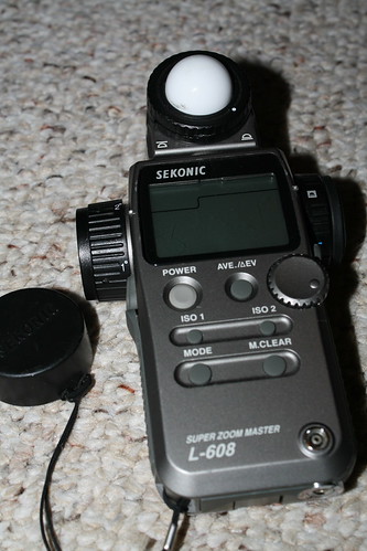

5. Light meter that i need to figure out.

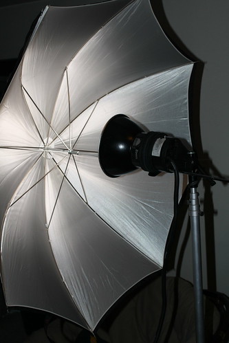

6. the umbrella and light.
IMG_1774 by RyanCorvelloPhotography, on Flickr

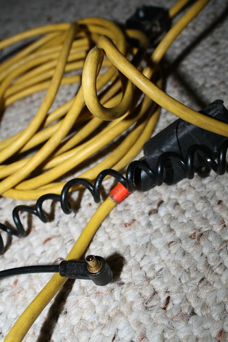

7. the adapter i received in the mail.

Damn your right , sorry that made no sense. "i look at the photo and its as if ONLY the flash fired and not the light through the umbrella.
What i have been doing lately(which is hate) is i put my camera on a long shutter speed(1 sec or maybe 2sec) and the flash and the lights fire and then i hit the "test" button one more time to make it actually look like the lights fired. If i DO NOT do that, then only my flash goes off.
Are you using the strobe in slave mode? If so it's probably getting tripped by the pre flash on the speedlight.
yes i put it in slave mode. i dont usually use the cord for the slave. When i place the cord into the slave and put the other end in my adapter, it doesnt flash. suuuucks
If you are using the flash from the speedlight(430EX) to fire the strobe(umbrella) then the speedlights pre flash may be setting off the strobe before the shot is actually taken. That would make the flash from the speedlight the only flash you see because the strobe would have already fired by the time the shot snaps.
that sounds like the problem but how do i fix that?
I don't know anything about Canon cameras, but you should be able to disable it in the camera menus. Check your manual, or maybe someone who knows about Canon can chime in for that one.
