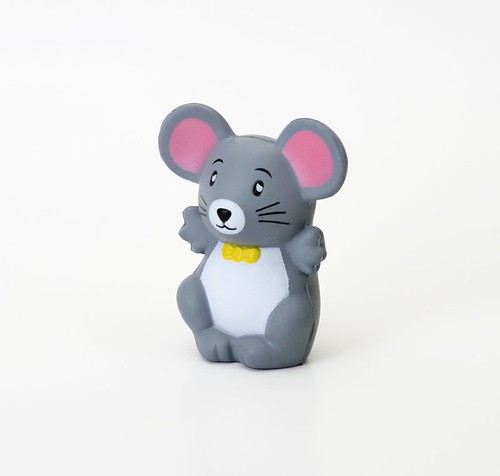

When I took photo with products, I use tether shoot before. However, when I need to take photos for many similar but different objects like this one
Then I do this.
- Setup the shooting environment. Such as white card board as the background. Put a little mark on the card board indicating where to put the subject.
- Setup my lighting equipments
- Set the camera on the tripod.
- Set the camera in manual mode with Aperture set at f/8 to f/11
- Remote shutter cable connects to the camera.
- Manual focus the subject and fire a test shot.
- Adjust the settings if needed.
- Once everything is set to go, all I need is place a subject on the little mark and press the button on remote trigger.
- Replace the subject and press the remote shutter again.
If you use tether shoot, you can review the result right away from your computer (or laptop) with a bigger screen before you swap the subject.
As you can see, once everything is pre-setup, you can go through a lot of items in a short time.
I think the key is subject is about the same size so that I can pre-focus. You camera is setup manual mode, so no need to meter the shot again. No AF and no meter, just replace the subject and click.
As for what camera can do that, I think any of the DSLR can do, even the entry level one.
