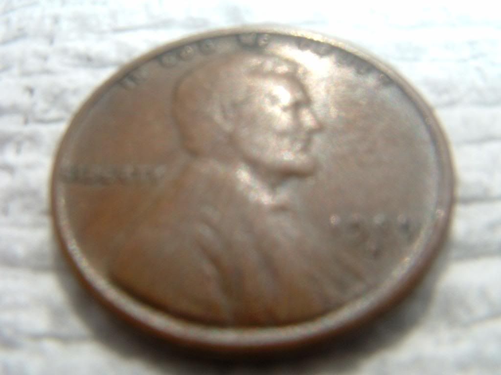

Hi im trying to use macro on this finepix 2650 camera to take a really closeup picture of an old penny i have.
However no matter what i do, the flash causes the picture to be completely whiteout.
Can someone help me!

If i turn the flash off its blurry and has no detail.
I used tissue paper but it still whites the entire coin out.

No flash all blurry, flash whiteout.
Theres pics of these everywhere, how can they do it and i cant?

The second "needs to look like this" photo has the penny parallel to the image sensor.
Your's has the bottom of the penny closer than the top.
Your's looks like you are to close, and are inside the minimum focus distance your camera is capable of. Page 43 of your user's manual.

Ok i got it now.
Thank you sir!
KmH is right, going by the photobucket link, you are simply too close for the camera to focus. Best bet is to move back a bit, and crop the photo once done.
