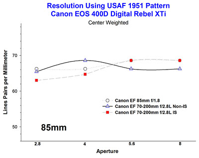

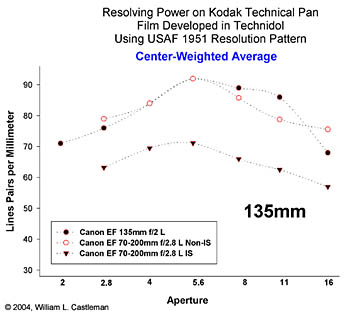

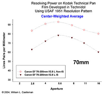

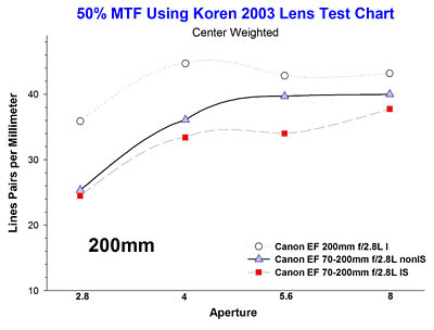

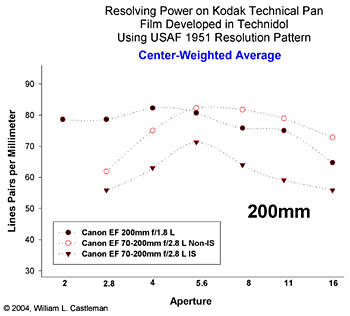

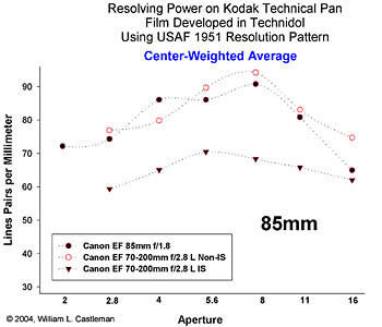

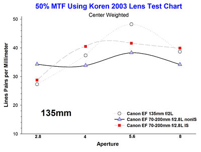

Resolution Performance Data - The non-IS lens outperforms the IS lens
Lens resolution tests were run as described here.
The non-IS lens consistently outperformed the IS lens in resolution at 70, 85, 135 and 200mm focal lengths. I was initially surprised by the lower resolution of the image stabilized lens. However, after reading more about the complex construction of the image stabilized lens, it is not terribly surprising that an IS lens with 23 glass elements in 18 groups is not quite as sharp as a superbly sharp non-IS lens with 18 glass elements in 15 groups.

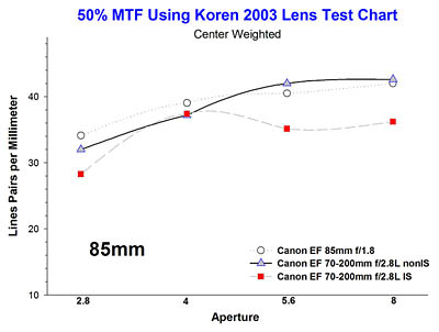

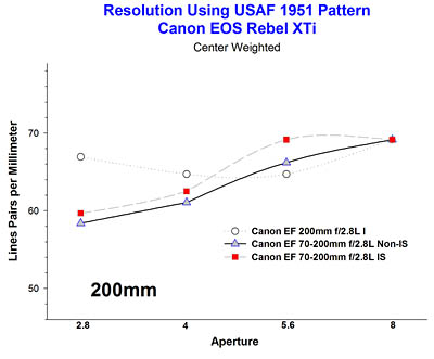

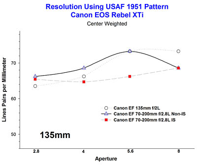

50% MTF Performance Data and Resolution Data- APS-C Camera EOS 400D Digital Rebel XTi
Methods for APS-C camera
The non-IS lens gives slightly better performance than the IS lens, especially when shooting at f/2.8.

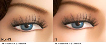

Detectable Sharpness Differences in Film Images and Digital Images
I tested whether the resolution difference was detectable in digital or film images using an EOS-1Ds camera and an EOS-1n camera with Fuji NPH film and the lenses set at 135mm. Details of the test method are here.
EOS-400D Digital Rebel XTi - Daylight f/2.8 @135mm
2007 Test (From Bokeh Tests)Tests run with an EOS-400D Digital Rebel XTi in 2007 showed sharper images with the Non-IS lens at 85mm and 135mm at f/2.8.Bokeh and Background Blurring Function: Slightly better background blurring at f/2.8 with the Non-IS Lens at 85 and 135mm.

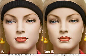

Image Stabilization Benefits - when you find yourself in low ambient lighting without a tripod.
Image stabilization works as advertised for hand held work. A photographic series taken handheld at 200mm under a constant light source demonstrated that I could shoot as slow as 1/15th second and get sharp images with the IS lens. 1/60th of a second was as slow as I could shoot consistently with the non-IS lens and get sharp images.Conclusion

The difference in sharpness is almost unbelievable...you don't need a closeup on the eye to tell that.
