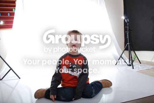

yeah that to mike. I do mostly boutique photos so I do a ton of high key. I used the sb-28s, cheapo triggers for the back ground and 2 studio lights w/ triggers for the subject. I also use the white board from home depot on the floor.
This shot shows my setup which is in a tiny (10x13) upstairs bedroom.
love the white board from HD idea. I like the shine it leaves on the floor.
