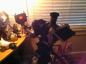

Here's a photo of my far from final setup. This is just for proof of concepting.
The bellows are an Asahi Pentax AutoBellows II I nabbed from KEH.com for around $30.
The enlarging lens is an el Nikkor 75mm f4. About $30 on ebay. Mine the guy claimed had been used twice. To say it was mint is an understatement. Even had the original price tag on the box.
At the end of the bellows is a slide copier that sometimes comes with these bellows. I've placed a single 35mm negative in it and am using a halogen bulb. This is far from my final setup. I am planning on building a vertical light table of sorts using opaque plexiglass as a diffuser and a ring of LEDs spaced behind for lighting. I would then create rails for the negative holders so I can move them horizontally across the camera's field of view. That's the end goal. For now I'm going to build the light table and tape the negatives to the plexiglass. I appreciate you going into detail about your setup, especially what materials you used.
