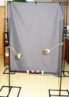

ok, so im starting to think about doing portraits and i need to create a second light source, aside from my on camera flash. i'm thinking about using one of those yellow heavy duty work lights and i was wondering if there is any way to make some sort of diffuser very cheaply.

Here is a cheap and easy solution for now. They have new light bulbs out (the new florescent) They have ones that are daylight. around $6.00 ea. You can get deskl amps from wal-mart for 8.00 ea. These angled the right way make pretty nice portrait lights. here's a pic with a complete DIY setup.
