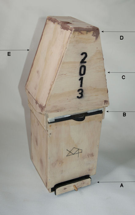

It's not 100% finished but good enough for making some prints from negatives taken with homemade cameras.
A Draw for multi contrast filters
B Negative holder
C Lamp House
D Bogging ... will look okay after sanding
E I'm lazy shouldn't have use the on-board flash
Because of limited space in my home ( small A frame cottage) and I will not be printing over whole plate. I have gone for a very early design of enlarger. The head will be fixed in the top of a three sided box and size adjustment will be by the baseboard the can be moved up and down.
This is the basic layout ,not like the modern enlargers, but on the lines of what the photographic pioneers would have used. Add some colour finish I think It's replicated that aged look

Now I must work out some runner system.. thinking cap on!

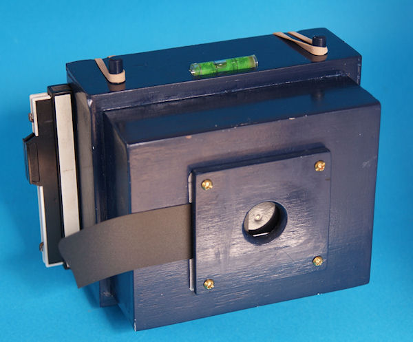

The test negatives where thaken with this homemade camera
Larger format 4x5 400micron pinhole

By the way I was using the lens on a old view camera parts I found on Ebay ( when ebay first started and there was some good stuff on offer) The camera was the Blair ( Kodak) Tourograph. Many will say it's a sin using a Russian lens on such a fine camera.. Oh well
