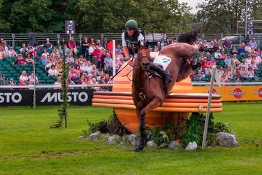

As photographing horses is my thing I agree with all the above, and would also add that there is no single solution, as so much depends on the light and angle you're shooting from. Although most of my work is portraiture, I attend Burghley and other equestrian events throughout the year, and don't have one set up. What I do do is use AI Servo (Canon man too) and try to keep my aperture at f11 or f16 if the light permits and shutter speed at 1/500 or less. If I can't then I move my position to improve the light and then sacrifice my ISO and deal with a bit of noise. Obviously the amount you can sacrifice the ISO will depend on your camera. Focus on the horse's shoulder, try to pick them up early as they come into the jump, and follow them in. Take your shots, but don't be tempted to stop moving the camera as you do. It's like shooting with a shotgun, you have to follow through. In fact I regular shoot with a shotgun too and find that it helps. :) The other option as already mentioned is to pre-focus on the jump. I prefer my way and you need to find what works for you.
The first attached image I took at Burghley in 2012 in the above way. Even though they nearly fell and the horse was going one way, and the rider the other, I was still able to get good focus.

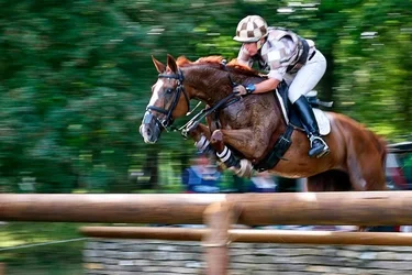

Don't be afraid to lose a bit of focus across some of the horse/rider, as that can work too. The second attached image in this link was at 1/60 sec.

The idea of the greater f-stop for a slower shutter makes sense for that second shot, but I don't quite understand the logic behind it for the first.
The suggestion of 3.5-5.6 by Gary lead to a much more appealing shot with the bg separation and bokeh. Your first has a very distracting bg and I keep focusing on the rear foot of the horse and how it's interacting with the bg.
It might vary depending what you want - the first shot might well have too much depth of field to be traditionally considered "arty" but might well be just what newspapers are looking for as a record of the day.
Braineack, as I tend to stand close to the obstacles and am panning, the f8 to f16 isn't usually an issue. As I said many ways to skin a cat. :) My first attached image was from way across the arena and about the crowd reaction, as the obstacle had been causing some difficulty. Sadly the low res image doesn't best show all the open mouths and hands coming up. That and some people who seem relaxed and half a second later were on their feet. It was published in Ireland together with a later image of the crowd standing and Sam Watson recovering his seat. An incredible piece of riding to recover and similar to an incident his father had IIRC.
