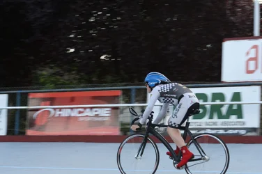

I have found a panning shot from years ago with my old 10D shot at 1/60 with 50F1.8 @ F4, so should not be a problem with XS

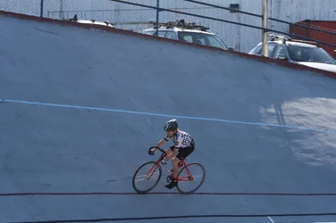

These three phots were taken with my 70-300 zoom, which is what I use most of the time at races, with a fast shutter speed. I didn't write down what setting I used, the camera was on auto everything.
