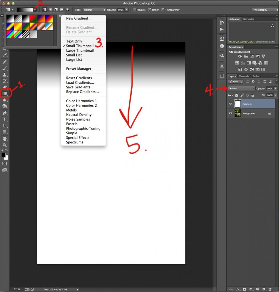

Here's a screenshot of the basics ... I smooshed the screen together so it would be a little smaller.
1. Gradient Tool
2. Types of Gradients (default). There is a little circle with rough edges on the right. Click on it for 3.
3. A list of more gradients that can be loaded. You will see the sets on the very bottom, including neutral density.
4. Blending modes and opacity.
5. Gradient. I drew a line straight down from the top. You can draw the line in different ways to get more black/grey/white as well as different angles. It helps to use 50% opacity when you are drawing to see how the gradient will layer over the background.
Hope this helps!
