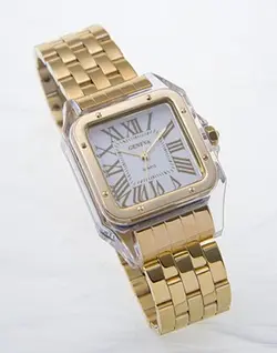

As a suggestion: there were three things I looked for while shooting watches:
1) there is some variation in the reflection; it is clear there is a crystal, and the shiny parts look shiny, matte parts look matte, but the face detail is not obscured (no strong reflection on the crystal), polarization can help here, but you (almost always) DO want SOME reflections. Usually, a strategically placed piece of mat board on the light tent is sufficient.
2) set the hands to 10:10 or 1:50 (one hand at 10 and the other at 2; I preferred 1:50) (thanks to L. Leathers, our marketing consultant, for this suggestion). If there is second hand, try to get the second hand around 5-7, on the same side as the hour hand, but never directly over or directly opposite another hand...it just looks odd.
3) the stem is pushed in. Analog watches often come with a tiny block to hold the stem out during shipping. Remove it before posing and push the stem in right before you shoot.
Also...
Watch out for fingerprints and dust. Wear (cotton?) gloves during posing if you need to.
Be very careful about sharpening in post. Specular reflections turn ugly fast. Very often, I didn't sharpen at all.
I often used a cube tent, then placed pieces of mat board around the outside to get the variation in the reflections. I tried to avoid variation in reflection on shiny hands; I thought it looked too much like the hand had an odd two tone effect.
I'm not saying this is the only "right" way. It was the way I did it and I never had any objections.
In the end: If the client likes the image, it's a good shot. If they don't, it's not (even when it's "right").
Attached is an example from my archives.
