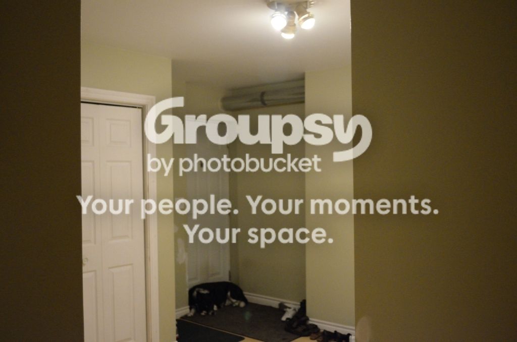

(this is the exact lighting in the room I am trying to take my picture in)

No, you just don't understand the basics. In this example, THERE IS NOT ENOUGH EXPOSURE TO GET THE SHOT. You shot at 1/1000 second and you probably needed 1/100 second or slower at ISO 6400 (which is going to result in a very noisy image).
Please, PLEASE, look at the link that Lew provided. It truly will answer all of your questions and once you understand the principle you'll wonder why it was so difficult to grasp.
Read above my guidelines for your shutter speed. Your shutter speed is far beyond what you NEED.
Slow down. You aren't at an event where you have to have exposure RIGHT NOW. SLOWLY think through what you NEED. You have very little light to work with. You need the slowest shutter speed you can possibly work with in order to get as much light in. That would be PROBABLY about 1/125.
Then you need to use the lowest aperture that you can use and get focus to get as much light in as you can. If you are zoomed it's probably 5.6. If you are using no zoom it's probably 3.5.
Those are what you HAVE to use. You don't have any other option with those two to get more light in. Your last resort is ISO. Raise it until you can get exposure
Your camera only has so much capability. At some point you have to add more light. The camera can only do so much without giving it more light somehow. You may not be able to get a decent exposure inside. Cameras have limits in their capability and lenses have limits in their capability.
