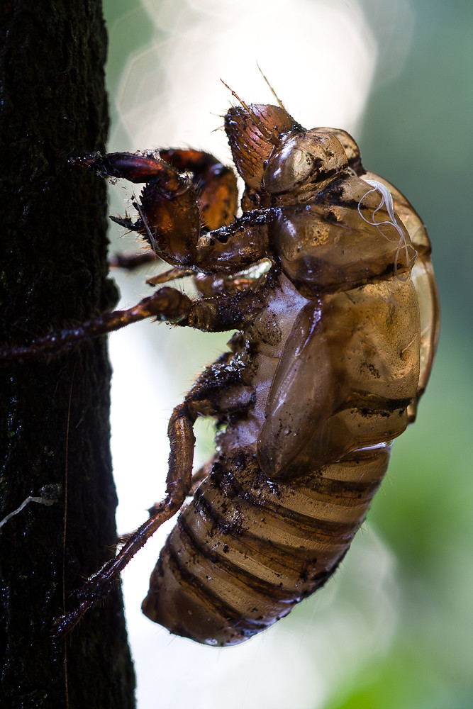

This photo was taken at 100mm and f/16, yet the depth of field is still so small that the behind legs are still quite blurry. This is because the lens was only a couple of centimeters from the subject, so anything more than a couple of centimetres behind it starts to get pretty blurry (to grossly oversimplify the maths).
