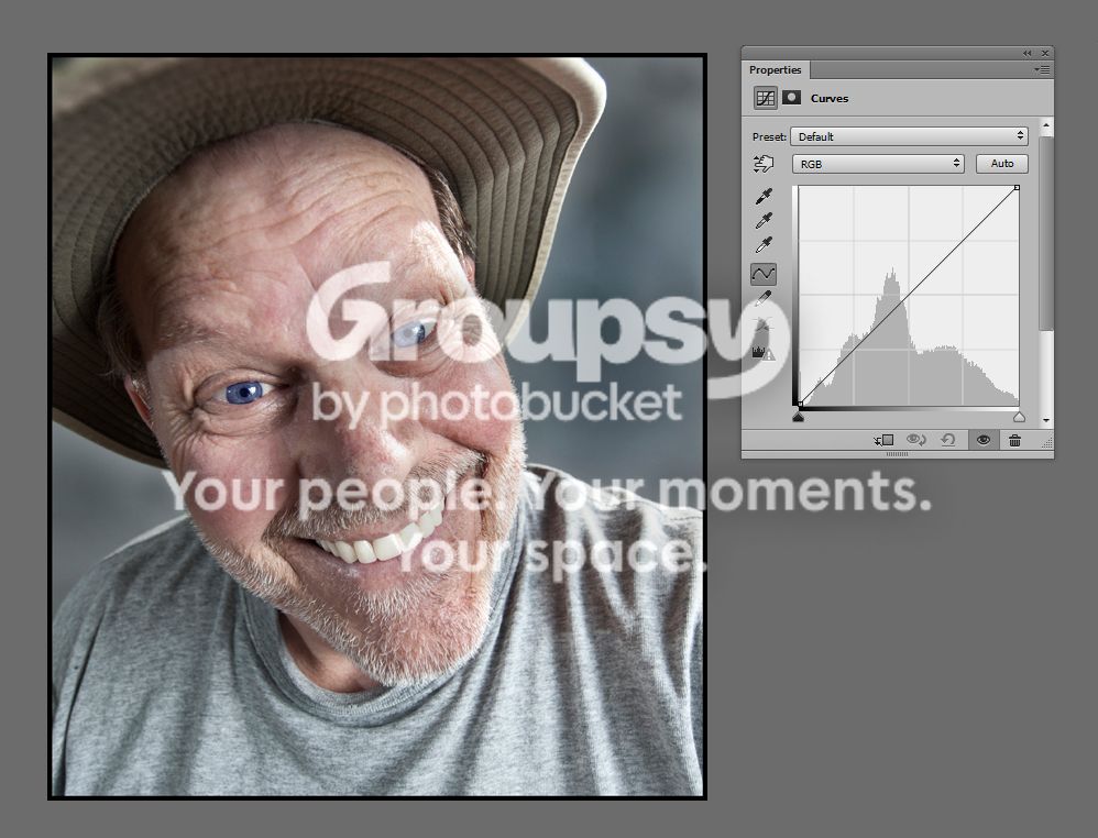

Make a Vibrance adjustment layer and reduce the Vibrance.

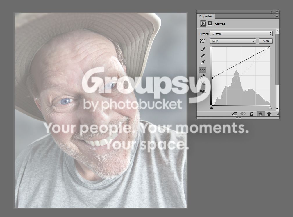

Make a Curves adjustment layer.
Grab the lower left end of the Curve line and slide it up until you get the amount of white haze you want.
You can also select each color channel and add a color cast like the blue (cold) cast in the 1st linked to photo, or any of several other techniques.
