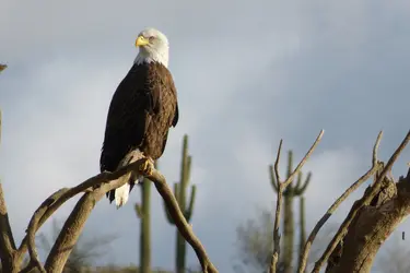

Amazingly awesome helpful answers one and all! I think all aspects were covered... I often shoot from my kayak, from there I can go and see things that are relatively rare, so the tripod question is out, and when you factor in the wind rocking boat...nevertheless, I got some good pics here and there.
