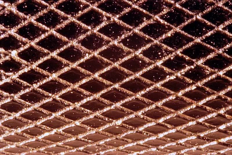

Taken with stacked Tiffen Macro Filters on Canon FD 50mm 1.4 on Canon EF
Taken Handheld with stacked Tiffen macro filters on Hoya 81A on Nikkor 50mm on Nikon FM (uncropped full frame)

Thank you very much for your valueable suggestions, Battou. And thanks for your macro shots. A big WOW to them!
What is the 3rd photo of? And what the last one?
