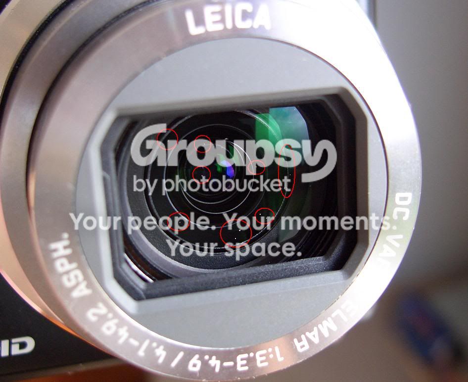

I'm looking for help that will allow me to get into the lens of a Panasonic DMC-ZS3 (TZ7) to remove dust.
So far I have stripped the camera down to where I have removed the lens/sensor module from the camera and I'm able to remove the sensor from the module but I don't know how to get into the lens to fix the problem.
Below is a photo of the problem I need to fix.
Any experts?

No big deal...just let it be.
Read this: Dirty lens article
Reassemble the camera.
Follow Darrell's advise.
p.s. Darrell, check my response to your post in the What Filter Thread.
After looking at the article I won't bother. She's all back together and working so I'll leave her that way.
