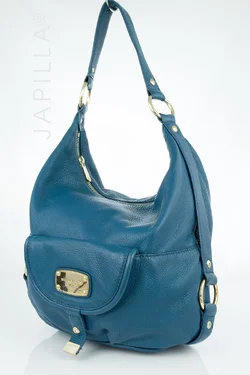

Could you guys please give me an idea of how many lights he is using and where?
I see one from the top right, and one behind. Or is his light on top left?
How does he get the right and left bottom corners of the bag illuminated? Are the bottom corners being illuminated only by the reflection off the white plexi glass? Is that even plexi glass?
What lens do you think he is using? Do you think this is continuous light or strobes?
Anything else you can see?
Thanks
Quo

FWIW, I would say the bag was illuminated with a single light high and right, and a small kicker on the background.
not seeing the picture that was attached ...
the answer is in the shadow(s), so check the shadow(s).
just take a purse, and a flashlight, move it around at various heights and locations to visually duplicate the shadow(s). If it's One light, you should be able to easily approx duplicate any shadow(s) though not the size and shape of the light source as easily.
Then use the flashlight to bounce it off of a surface onto a subject, and understand reflection lighting some more.
You may want to reread chapter 5 - Revealing Shape and Coutour in your light, science and magic book.
just the image ==>
http://i.dailymail.co.uk/i/pix/2015..._tote_retails_from_260-m-16_1431199753789.jpg
Look at the shadows, and brightness going to darkness.
dark shadows underneath the left and right edges, and the emblem tag clearly show a light from above, and the angle that the light would be at.
You are getting white reflection at the bottom of the bag from light above bouncing off of the pedestal back up to the purse.

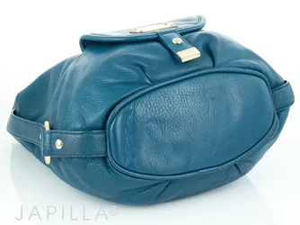

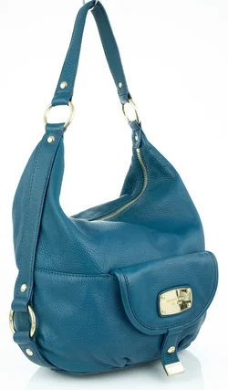

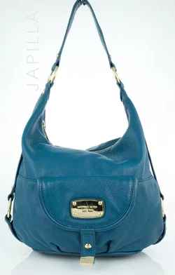

I just shot these up close at 35mm. Astro Nikon just warned me about distortion. I know nothing about distortion. Are these pictures suffering from distortion?
I do not understand how to detect "distortion". I know what the word means in English, but do not know how it applies to these bags.

I read up on distortion...it's more what BULGE is in photoshop, a bulge effect coming at us....ummm
For future pictures, you may want to try to smooth the bag over with your hand or somehow get rid of some of the bulges. It looks very lumpy.
Also, the logo on that bag, which I'm assuming is probably the most important part of that bag, is not clearly visible with lots of reflections in it. Just something to consider if you reshoot.
