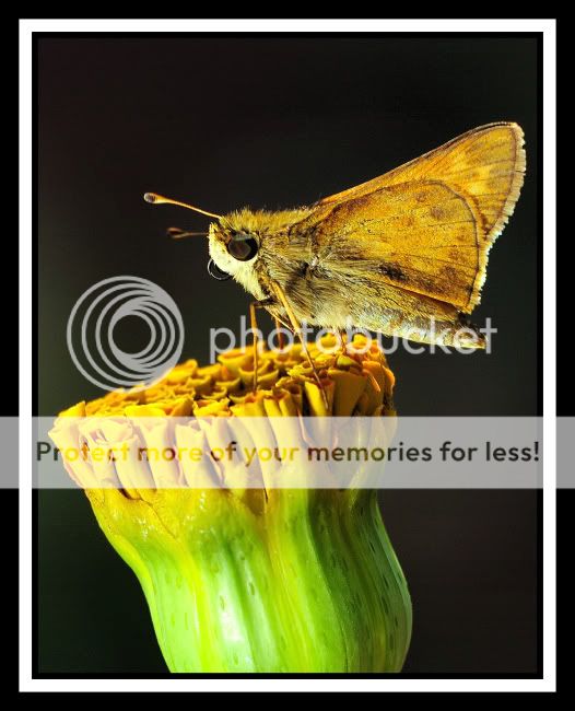

THis picture is high noon with no overcast and very very bright out. Settings were 1/250th shutter speed, F/14 with the flash on the subject. The black background is actually my green lawn. With 1/500th shutter speed I could have made the background completely black (that's not the look I wanted though).
It's really simple, meter the shot so that it is horribly underexposed.....even snap a shot and see if it's basically black. Then kick on the flash and use the flash to light the subject and you'll end up with a black background as long as the background is a good 3-4 feet away or more.
