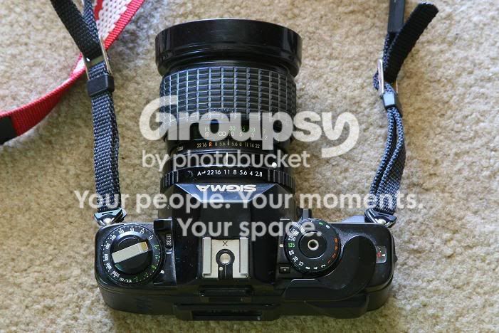

So my girlfriends parents had a yard sale this past weekend and all the stuff they didn't sell, they were going to give to Goodwill. Well they didn't sell her fathers Sigma SA-1 and I asked them could I have it and they said sure. Well I was playing around with it without any film in it (pressing the shutter release and doing the film advance lever thingy) and it got to "S" on the film counter and the film advance lever is loose, not ratchiting like before. I replaced the battery in it this morning to see if that would help but it hasn't. Somebody helllp!!!!

I already tried that. I think the problem lies with the film advance lever. It doesn't have any resistance or ratchiting to it at all.
Gads it's been to long since I played with my film camera - so this advice may be faulty. I know there "should" be a small button on the bottom of the camera - but don't remember if that allows for the rewind of the film or resets the film advance.

Dang, tried it after your suggestion and no workee workee. I think I'm gonna take it to the local photo pro and pick his/her brain about it for a while unless anybody else has a suggestion.

Most of my manual advance cameras will ratchet and set the shutter regardless of the film counter. Remove the lens and look at the mirror. Is it in the up or down position?

Ok.. let me be more specific... Without film, None of the Pentax manuals (S1a, H1, H3, K, H1a, Spotmatics, LX, ME, MX, ME-super, ME-F, Spotmatic ES, K1000), none of my Canon's do it(A-1, F-1, AE-1, Pellix, Canonets ALL of them), my Minolta XG, none of my Leica rangefinders do that, and none of the other 35mm cameras in my collection do it. The counter just hits the highest number and sits there. MOST cameras do not have the advance lever tied to the counter. The camera will continue to advance and trip without any lock. The Sigma is a camera based on the K1000 internals (IIRC / like many cameras of that time) which equates to the same mechanisms as the K1000 which does not lock at the end of the counter. The film counters will reset once you open the door (on most cameras) but this is still independent of the film advanced lever. Perhaps the Nikons work differently.
[EDIT] The Sigma SA-1 is a rebadged Ricoh XR-7 with Kmount not the often copied K1000 [EDIT]
What you are describing is behavior when film is LOADED. The film is pulled into the take up spool. Once the last frame has been reached, that end of the negative is taped to the main spool which means it won't allow you to advance. If you advance the leaver hard enough, you can tear the negative (don't do that). That would translate into a "locked" advanced leaver. Without any film in the camera, the advance lever will happily spin the takeup spool and reset the shutter forever.

If the mirror is in the up position, the shutter mechanism is jammed. Need repair.
If the mirror is in the down position, the shutter mechanism might be ok but the ratcheting mechanism in the advance is broken. This can occur of you are advancing/tripping too quickly and try to advance prior to the shutter mechanism resetting. Battou is right. Dry firing normally won't do damage. (I do it occasionally just to hear the quality of a nice shutter.. lol)

The mirror is down, but the film advance lever is loose. It stays in place until you go to advance the film, then it just moves freely. No ratchiting.

on my dads film camera, it is "loose" when its already cocked and set. The last time you used the lever, did you take a picture? or did it not let you?

It wouldn't let me. The shutter trigger acts as if it has already been triggered.
