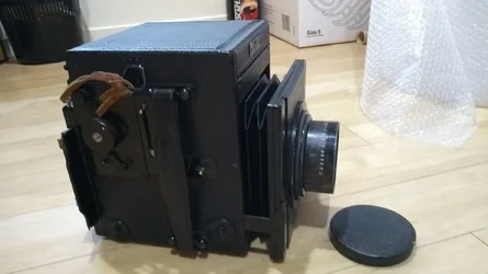

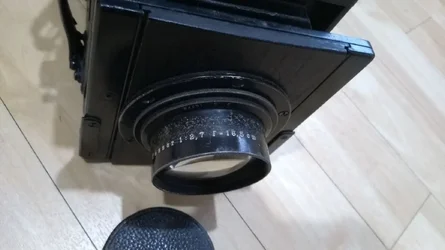

Is that a beauty!
Managed to acquire this beauty to add to the Marion collection
Was not sure if it was a Soho Night Reflex or not. Could only find images of one online.
It has a massive and fast Carl Zeiss 16.5/ 2 7 lens .
