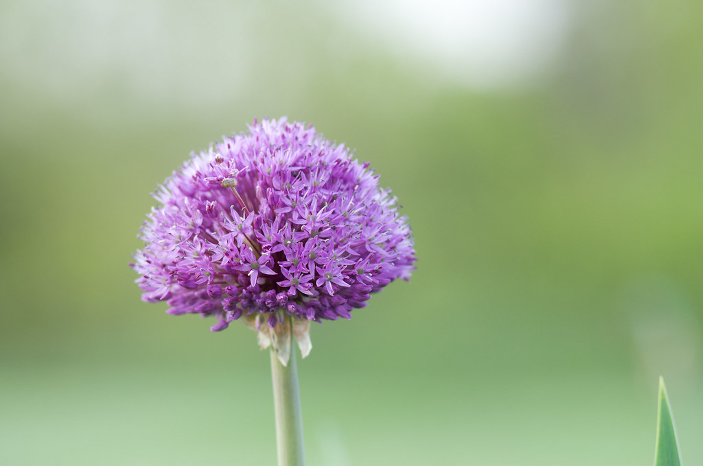

I'll play....
Taken at 125mm 1/320sec f/4.0 ISO 400. SOOC (raw processed, nothing else done)
DSC_1663 by Matt Francosky, on Flickr

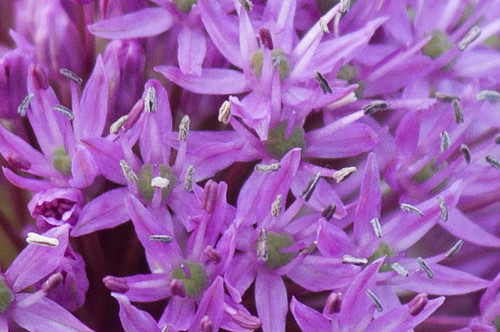

100%(ish) crop of focal area....
DSC_1663-2 by Matt Francosky, on Flickr
Taken with a D90, center weighted metering, AF-S single spot focus, hand held.
