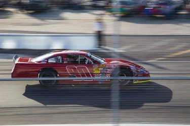

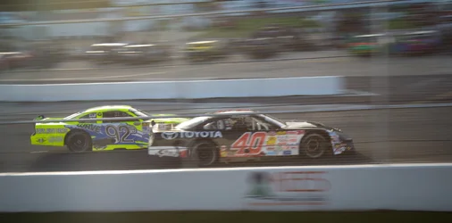

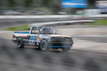

Good morning to all! Took my children to Langley Speedway in Hampton, VA and while there I tried panning for the first time. Any C&C is appreciated but I would like tips on technique for panning. Thanks in advance.

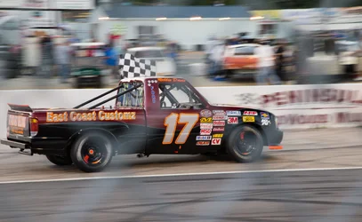

Not my child but I though the expression was pretty good.

Panning looks pretty good, but the fence is killing you!

Yeah there really wasn't much I could do about the fence except get higher in the stands but then I don't have a lens with enough reach to fill the frame.

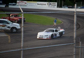

Yeah, actually there is. This, for example, was shot through a fence:
Two tricks: First get as close to the fence as you can, and second use the widest aperture that you can get away with. That way the fence won't be within the depth of field and you'll never see it. When panning with motorsports leave yourself enough room that you don't bang into the fence as you turn and stay away from sections of fence that have bright sun shining on them. The reflection from the sun will make a ghost on the image that is visible.

On another note there is nothing wrong with your panning other than the fence. Perhaps kick the shutter speed up a little, say 1/125 instead of 1/30, so you get a little better sharpness on the vehicles but still they are very well done.

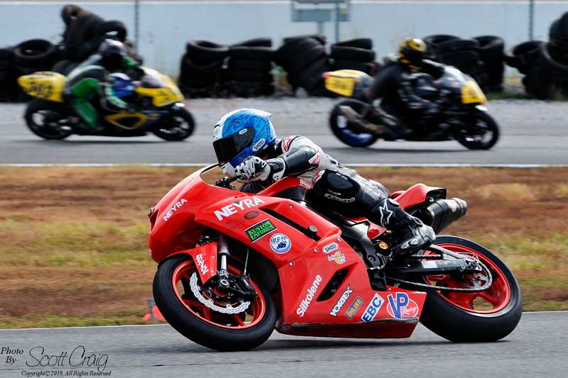

These were taken at a WERA race here a couple of years ago.
This guy was probably doing 60-ish after coming off a corner and starting to accelerate down a short straight on a road course. I shot it at 1/200 because I was trying to catch a blur of the bike in the background. It was shot at 125mm and not cropped much, I was probably within 30' of the bike as it came by me.

The point of both is that shutter speed is dependent on distance, but even a relatively fast shutter speed will convey motion. That close, even with a relatively fast shutter speed, you can get really good motion blur yet keep sharpness on the subject. The first time I went to that race I shot a lot faster and was disappointed with the results. This one was taken at the exact same spot as the first one but rather than 1/200 second it was shot at 1/800. The background is frozen, the spokes on the wheels are frozen, and it just doesn't convey the motion as well. Play with your settings next time and find what works best for you, but I think you'll get a little better sharpness on your subjects with a bit more shutter speed.
