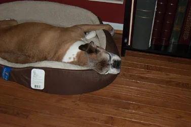

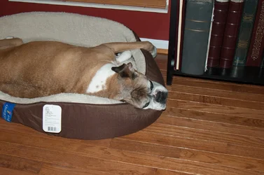

I am a hobbyist photographer. Have been using my DSLR Nikon D50 for several years now and used it mostly for photos of my kids and sports....but I found out I really love the intricacies of photography.
My question is....I usually try not to use flash at all but when I do I only have/use the in camera flash. I just took 2 identical photos with in camera flash on and aperture of f/8 and one at f/2.8 with a Tamron 28-75 1:2.8 lens. The image with the smaller aperture (f/8) was brighter....why...both had the same shutter speed of 1/60. Does the in camera flash change based on the metering, settings, etc.? I would have expected the smaller aperture to be darker with everything else exactly the same.
This was an indoor picture at night. I took pics in raw and exported to jpg for attachment using PSE12.
Thanks.
I'd imagine that some of what you are seeing is the natural vignetting of the lens at f/2.8 and the effect it has on metering, coupled with the randomness of TTL flash metering.
Wouldn't vignetting just be around the perimeter of the image? You can tell that the exposure in the center of the image is different which seems like it would not be due to vignetting.
So, you mentioned randomness of TTL flash metering...does that mean that the in-camera flash does behave / flash differently based on metering/settings, etc ? If yes, why didn't it compensate for the smaller aperture and expose the photo correctly?
Basically, if the flash is on, how does it determine what to do?
Thanks for any help.
Hard to say specifically without knowing lots more details. ISO is a big one to know, and also the indoor light level. But the big picture is pretty clear.
f/8 would adjust the TTL flash power level stronger, to maintain same flash exposure, to be sufficient flash for f/8. f/2.8 would use 3 stops less flash power (only 1/8 as much flash power) to match the aperture, to maintain same flash exposure. Both should be the same flash exposure, enough to be correct for the aperture.
But all flash pictures are possibly/probably a double exposure, two exposures, flash and ambient continuous light. (one of them could be insignificantly low sometimes, but in general, a double exposure).
The shutter speed does not affect the flash exposure. The flash is faster, more instantaneous, it just has to fire sometime while the shutter is open.
Shutter speed does affect the ambient exposure, but it was a constant 1/60 here. However, the f/2.8 lets in three stops more ambient (8x more), but f/2.8 instead turns the flash down 3 stops (to still be same flash exposure). This 3 stops is a big difference, which affects the sum of the total of the two exposure sources.
And if at high ISO, f/2.8 might have been closer to a correct exposure for ambient, so that ambient can be seen much better to make much more difference. But at f/8, ambient would have been underexposed 3 stops more (at low ISO, f/8 would be a dark ambient picture). A "Balanced" flash system (which D50 is) could react differently to the relatively bright ambient offered by high ISO, so we still have missing details.
So, what would be interesting to see, is the same picture repeated twice more, at same 1/60 and same ISO, at both f/2.8 and f/8, but without any flash. These would be dark pictures without the flash ,but would show the contribution of the ambient to the total illumination (good clues). The total exposure is the sum of the flash and the ambient. If the ambient is brighter, the total illumination will be brighter. Flash pictures are double exposures, flash and ambient (a very necessary thing to know).
