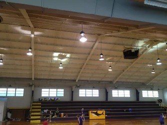

Thanks for the replies, I will try setting the exposure values before the game and see how that goes and see if adjustment becomes necessary. The lighting looks fairly even to me, but it is a very old gym and the only light we have are the big metal halide/sodium vapor, there is no flouresceant lights interspersed to even the lighting, as I see in some of the newer gyms in the area. So there is bound to be hot spots.
Edited to add a picture of the gym lights taken with my phone at practice today.

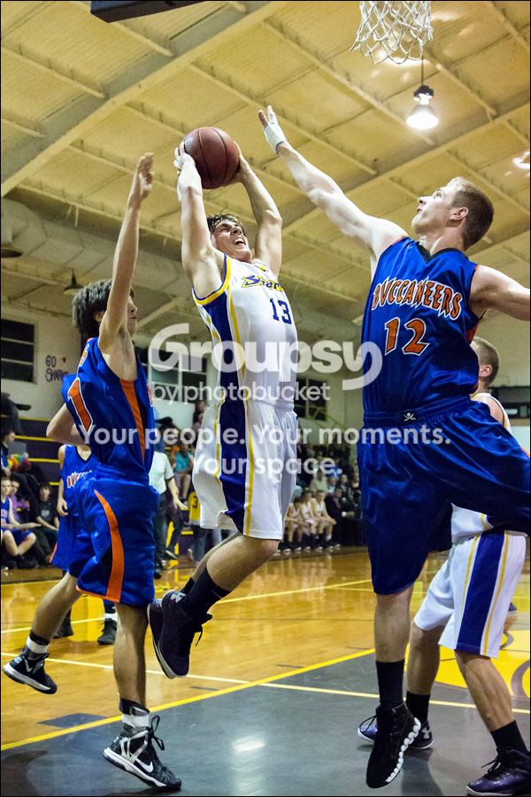

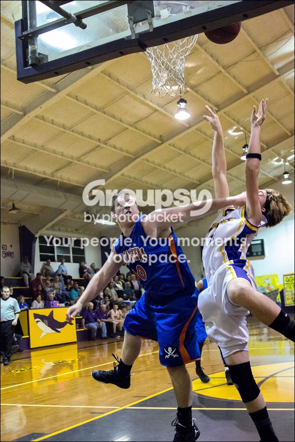

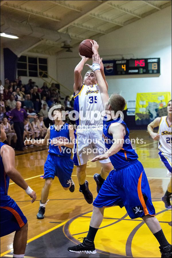

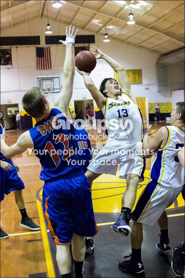

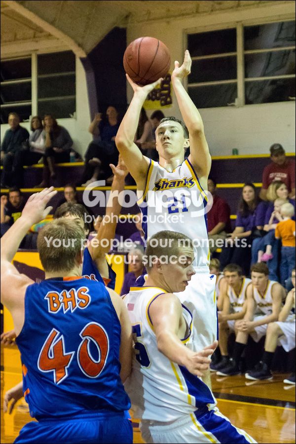

Here are a few from Friday, I still got a ways to go, but I think I'm getting there.
I think this might be a foul....
And this one is my kid. I really dislike shooting wide open, at this end of the court I was shooting f/2.8 @1/400 at the other end I was able to get F/3.2 @1/500 that 1/3 stop made a difference in sharpness,
