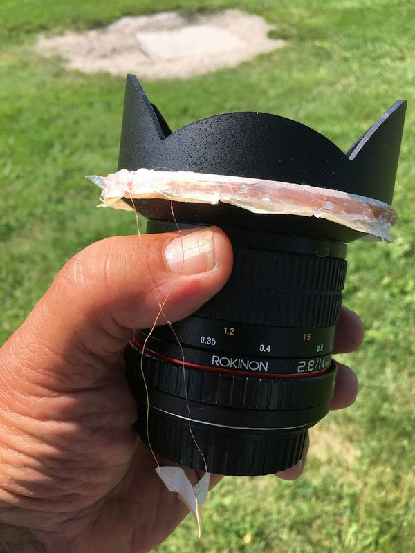

12V power, so I can take the camera anywhere. If things look a little white or dusty, that's frost. But the lens has none of that because it's got 100+ turns of wire around it, plugged into the 12V. And not showing very much is the continuous power battery replacement in the grip. One battery and one battery eliminator set at 9V. And finally a remote shutter cable.

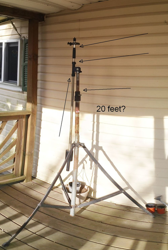

Well as usual, I'm slacking off. I skipped February altogether and here we are in March? Lets see, Macro, camera on a stick, where have I been. Night sky minus the dew and here's something a little older. I made this for shooting over the corn. Does anyone want to know why? Just imagine, there's corn and I wanted to shoot the field or the Sunset. :friendly_wink:
Only three extensions actually, and two camera mounts. The top one is just a straight Mic threading to 1/4x20 and the side mount has the ball so it can be adjusted better. It was an old light stand for a stage light, that I've been dragging around for ages.
This one doesn't go on the road.

Meanwhile the temperature keeps dropping and without the heater, I'd still get dew and frost. The idea of winding fine wire around the lens, is based upon what people do with telescopes.

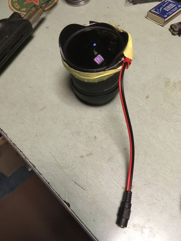

Here's one from Fall last year. The white on the tripod and the battery unit is frost. This shot is morning when I picked up the camera. The lens is nice and clear. I was very pleased. It took some tries before I got it to work right.
First wrap is masking tape, sticky side up, sealed in RTV silicone, then heat shrink tape was added over that. The plan is, if I ever get to that, slide off the heater wires and use the lens in the field for other things, without the ugly additions.
This is the 8mm, from the first attempt. Aluminum foil to distribute the heat, then fine wire, covered in foam and then some "eatra special" yellow masking tape over the whole thing.

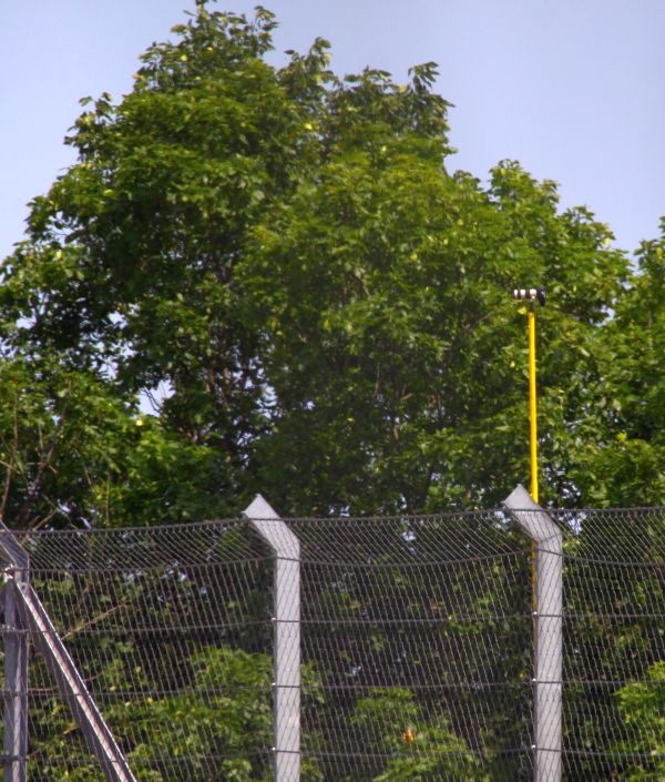

I don't always build everything. Sometimes I just adapt parts and pieces. The 40 foot big yellow monopod (which is less than that, but it started at 40 feet) came home because I saw it sticking out of a dumpster. The last segment was broken off. Easy enough, epoxy and a wooden plug, drill a hole and put in a stud for the 1/4 x 20 camera mount. Later I added a ball head.
Super monopod! Able to peek over tall fences.
