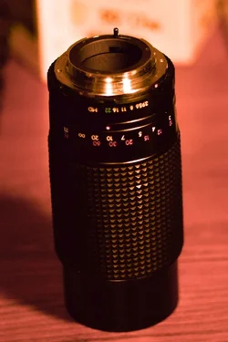

but this minolta lens will not completely focus to infinity $DSC_0156.webp$DSC_0158.webp
Here is the lens, so you guys can see for yourselves.
It's because the Minolta mount is designed for a smaller flange distance than the Nikon mount. So your adapter either won't let it focus to infinity, or it's a cheap, poorly calibrated adapter using an additional glass element that still just didn't provide the exact distance needed.
