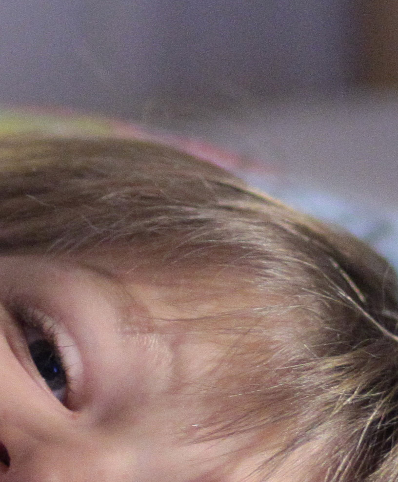

Issue with Color noise @ 1000 Iso Canon 5D MarkII, 50mm f1.4, jpg.
Jerry,
thanks a lot for this example, Actually no problem to edit this picture, I send the high resolution so feel free ;)
I also tried from my side to play in the canon photo editor and quite removed all the chroma noise in the raw file.
I will do some other tests and check if I still get this kind of artefacts.
I also see that NR has a big impact on details, and it is quite hard to keep hairs while removing noise...
I think I like to keep luminance noise, it reminds me the film grain, so that is quite good for me, thanks for your test!
Raph
My NR application on your pic had some very negative effects, but I just cranked the settings up to full on purpose so you could see the worst case scenario. Second, they were done on a 8-bit JPG, not the 16-bit RAW, and that never helps. :)

Hi,
Your noise is most definitely not normal. I'm experiencing the same thing - it popped up out of nowhere a few days ago. A bunch of chroma noise and an overall loss of detail and sharpness. Mine is a bit worse than yours though.
After some exhaustive tests, micro adjustments, settings, etc, I've come to the conclusion that my brand new camera needs some service.
When it's working well, the MKII's noise reduction is fantastic and I didn't see much, if any visible chroma noise until I hit ISO 1600 and even then I'd really have to be looking for it.
Sorry to be the bearer of bad news, but it's probably just going to get worse :/
Hello there,
Here is a sample of a picture I did this WE, I have updated the Firmware of the camera to the 1.0.0.7 because I heard about some bending problems on the 5D.
It was shooten in JPG Large size, If you look on the background, on the dark Out of focus part of the picture, you can see clearly a strange noise problem with greens, and reds colors. I am not found of that , particularly for a 3,000$ camera...Is is normal??
here is a crop:
and full resolution:
http://raphael.lacoste.free.fr/thephotoforum/IMG_7097.JPG
Are there some Canon users down here? do you think it is a normal issue with this condition of lighting ?
thanks!
Thats a HUGE difference between this pic and elrafo's.
Yeah, there's a ton of color noise in his at ISO 1000 and there shouldn't be. It could be the JPG conversion in camera, but then the noise reduction should take care of it and make it look plasticy. What could have happened is that it was underexposed and whatever program he uses to browse/edit bumped up the exposure to get an acceptable histogram, which in turn created more noise from the photo.
I'm just posting a photo that was taken as a 5D MKII RAW file at 4000 ISO with no noise reduction and no editing besides the conversion from Canon RAW to JPG.
Hey Village Idiot , (sounds like I am insulting you lol)
Did you turn off also NR in Digital Photo Professional Editor before exporting? seems like there is a default value (4-luminance 5-Chroma) if you don't even use NR in the camera settings. If I really turn off these settings to 0 and Apply on a raw file in the editor, I can clearly see green and red dots.
