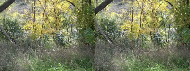

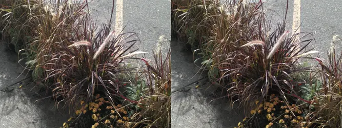

I have four samples to upload right now. I have more pictures that I am looking through, and I have tried to make some new videos. I will discuss this later. For now, I have listed the original file names and their corresponding original sizes, followed by the names of the "recompressed" files that I am uploading.
One word about 3D compositions: If you do a good job of composing in 2D, you might not find a 3D version adds anything. The result is a disappointing image. On the other hand, the samples I am uploading to day, I would call "poor" 2D compositions, but if you see them in 3D, you will find them much better. It is possible to have compositions that are good, both in 2D and 3D, but having done this for years, I would say that I do not generally like such "universal compositions" because they tend to be "obvious". I like the compositions, like the pictures I am uploading, which are not so obviously "good" when viewed in 2D. The element of surprise, is something that I find attractive in these compositions. This is, of course, a personal taste issue, and someday I might change my mind about it, but that is my current taste/opinion.
"IMG039.JPS" [Not Uploaded]
"IMG039-C13.jpg"
"IMG042.JPS"
[Not Uploaded]
"IMG042-C11.jpg"
"IMG045.JPS"
[Not Uploaded]
"IMG045-C14.jpg"
"IMG066.JPS"
[Not Uploaded]
"IMG066-C10.jpg"
