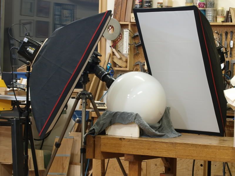

Next is a 16" acrylic globe with a 5" opening purchased from a local lighting company for $65. A less expensive but smaller option is 10" glass globes with a 4 1/4" opening available at local building supply stores for less than $15.
Note - the camera/lens combo in this image was not the one used for the shot, I was testing a 50-200mm lens and as expected the minimum focusing distance makes this lens inappropriate for this work.

That's interesting. The globe looks MUCH better, but it kind of makes sense. The globe is much smaller when compared to the tent, with a smaller hole. Both of which leads to more trapped, highly concentrated light.

I reshot with the globe on a gray T-shirt, added a strip of gray paper to the back on the inside and another small piece at the front just out of frame.
This is much closer to what I envisioned being able to do with the globe.
