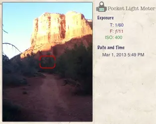

Well I just did a field test. Shot a roll of film and got it developed. To my surprise every frame was exposed and one could argue properly. I used an app called Light Meter, seems to be accurate and it's free. A good way to log your shots and settings.
Things I have noticed. I am not that steady with this camera. The shutter release just seems odd to me. I might be able to handhold at 1/60th but probably not consistently. Also, you must set shutter speed first when setting a specific Tv/Av. The film advance did stutter in mid roll once. Kind of spinning it's gears for a bit. On the negatives there was about 1/2 frame spacing between the two. Luckily I guess there is enough film in the roll because the last pic was not cut off.
