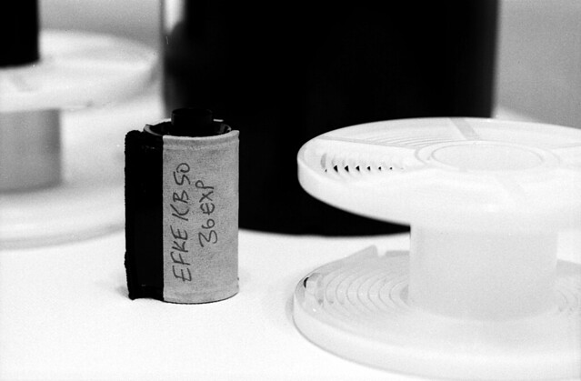

One warning though - they can open if dropped, so tape them up good. You need something to write down what kind of film is in it anyway.
I tape mine like so:
04071129 by J E, on Flickr
(Notice that it's taped on both sides - the one in the back is kinda hard to see.)
I've never had one come open taped like that.
