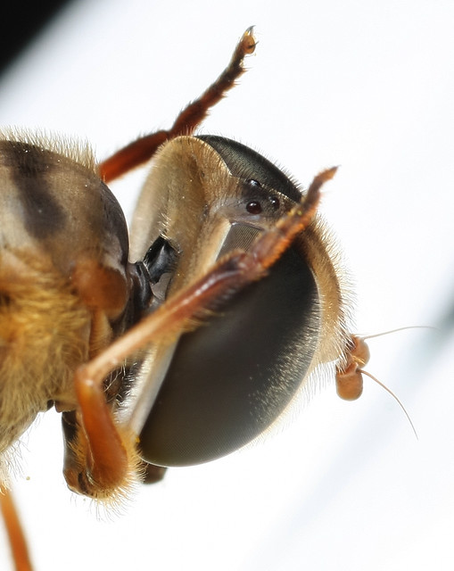

ps for those doubting the quality of filters:
and a 100% crop
Taken with Canon 400D, Sigma 150mm macro, Sigma 1.4TC and a Raynox DCR 250 (fair amount of added glass after adding teleconverter and the close up attachment)
