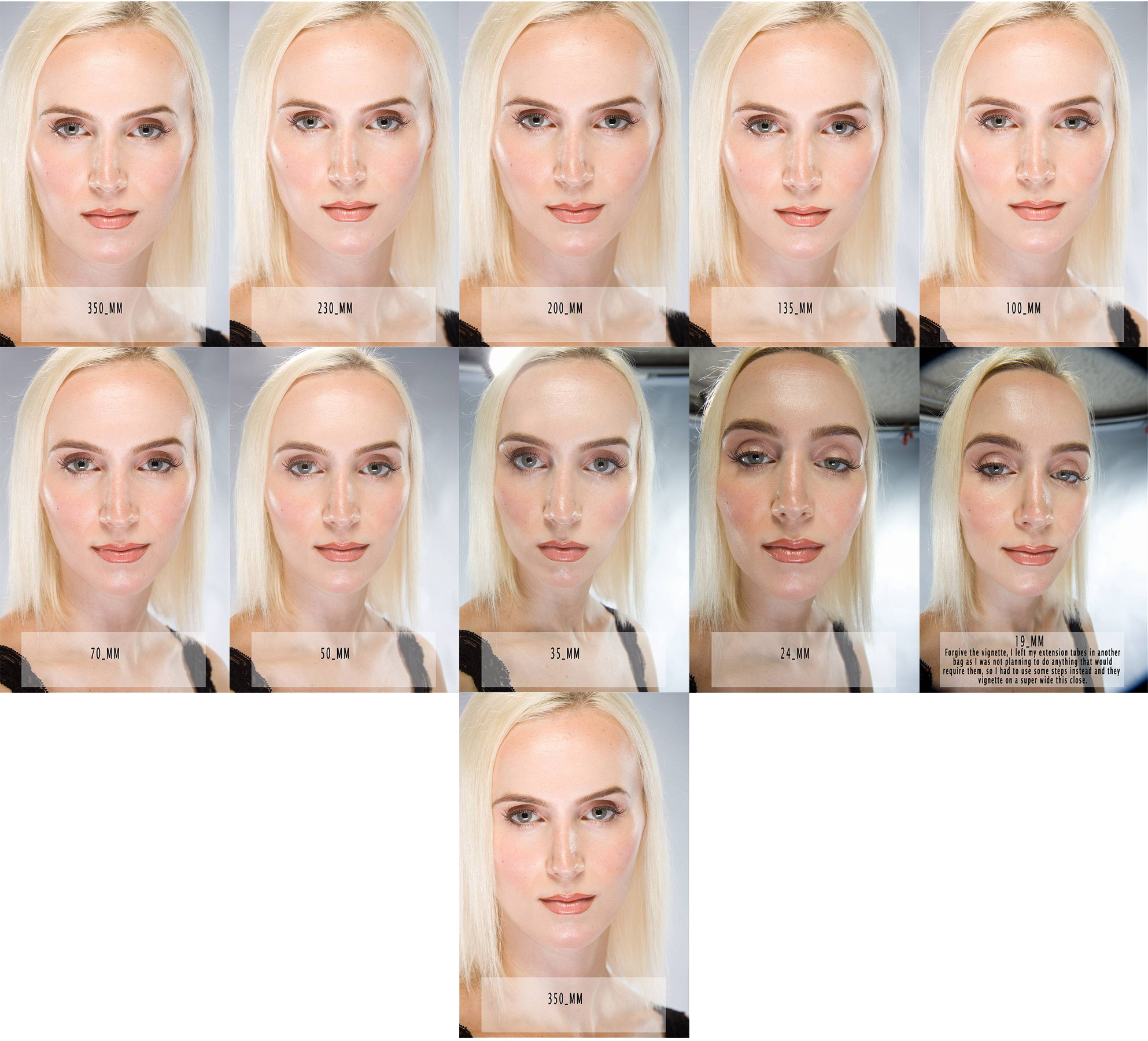

The focal length of the lens has a HUGE impact of how your portrait will look...
(Thanks to Untitled Document for the image)...
You need to account for 'crop factor' on your D90 so that 35mm 1.8G will be close to 50mm on that chart.

Uh-hu. This stupid "focal length gives distortion" myth will never die, will it ?
If you photograph a flat object, such as a wall, any non-fisheye lens will give you straight lines. Well, more or less - lenses arent perfect. Thus the "distortion" really comes from perspective, not from the lens. Its like the people in the middle ages believed the earth is flat - they stood right on it and it looked flat from then. From space, i.e. from a distance, you can see its a cube, though.
So that image only tells you "dont get too close for good portraits". Because then faces look funny, but thats a question of perspective - you are too close - not of focal length. If you keep your distance, only a fisheye lens will really have a lot of distortion.
You can make good portraits with almost anything. Even with a 21mm - all you have to do is keep distance. Naturally you wont get any face portraits this way - you will have environmental portraits instead.

It is called perspective distortion. Your explanation that the focal length doesn't provide distortion is BS.
There's wide angle distortion, telephoto compression distortion, all apart of perspective but you can't get wide angle distortion @ 100mm. Can you?
Sure, the distance of the subject makes a difference, but if the distance is identical, the image isn't the same. The focal length changes the perspective. That's how it is.
To complain about the "myth" is ridiculous, because one does correlate with the other and you're splitting hairs.
It's essentially the "Guns don't kill people, bullets do" argument.
