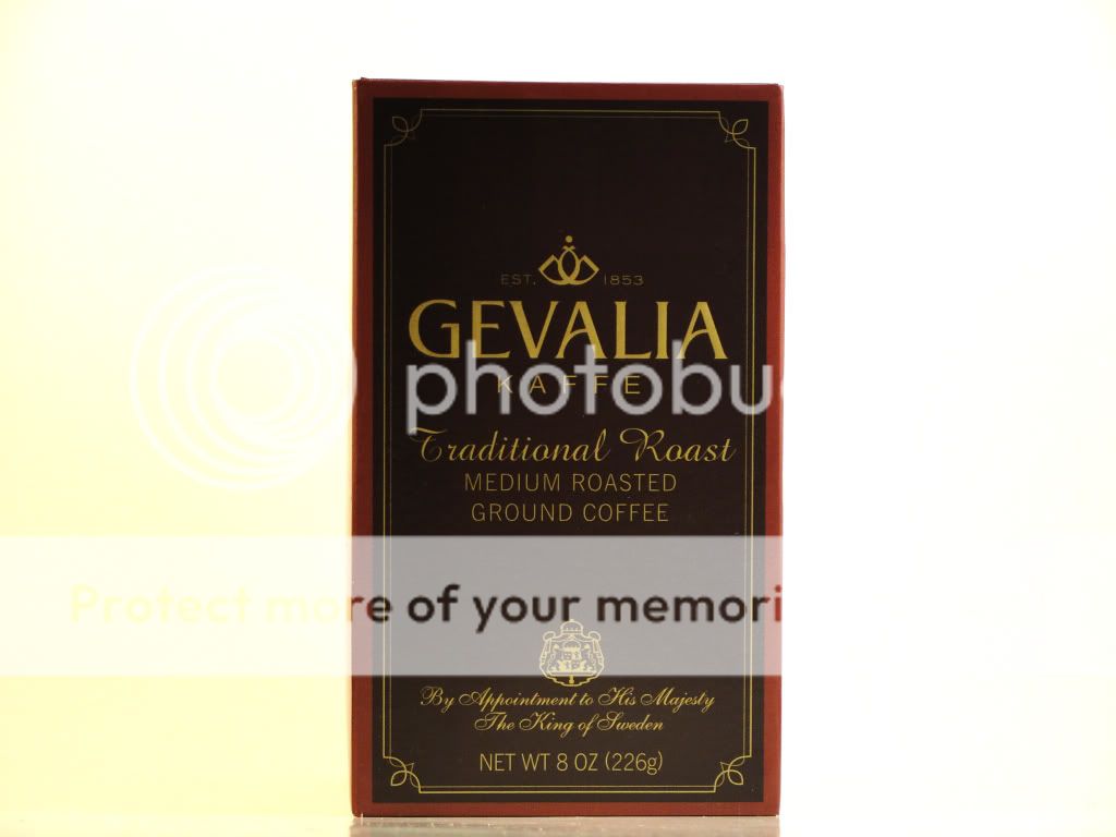

Nice shots man ;) and thanks for the advice. Anyway, I got some white tissue paper and put that around (but still have yet to get the white bulbs). Any comments on these?
You have yellow showing up on your sweep from your lighting.
The coffee box has uneven lighting, the top left is under exposed, where the bottom right is properly exposed.
Yep i noticed that too. And the yellow issue is because the one white bulb that i do have is on the right and the yellow is on the left. (Would that have something to do with the exposure issues?)
what kind of "white" bulb are you using?
Either way, you need to get rid of the yellow all together, and you need atleast 3 lights to get this all dialed in (maybe 4).
I'd go with one at the right corner, left corner, top angled so it's hitting the front, and one on the back top for back light.
Then spot meter off the face of the coffee box, and you should be good.
You could easily fix the white balance right now, but it would be a bit harder to fix the uneven lighting you have on the box.
Sorry, when i say "white" bulbs i mean daylight bulbs. And ill try it with three or four lamps tomorrow when i go to pick them up. Heres some lemons i took with one "white" bulb on the right side of the box :P.
