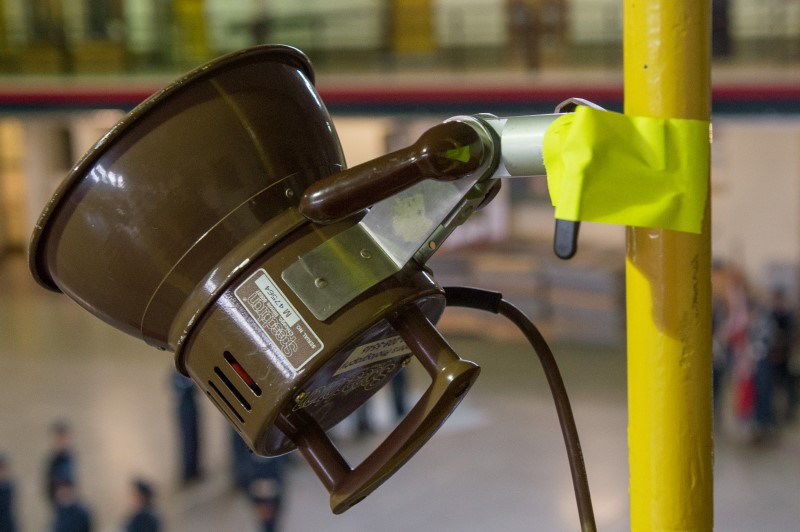

The lights were held in place with magic clamps, and the cord was passed twice through a turn-buckle as a safety measure in case the clamp let go; had the turn-buckle not been there I would have added para-cord safety lines.

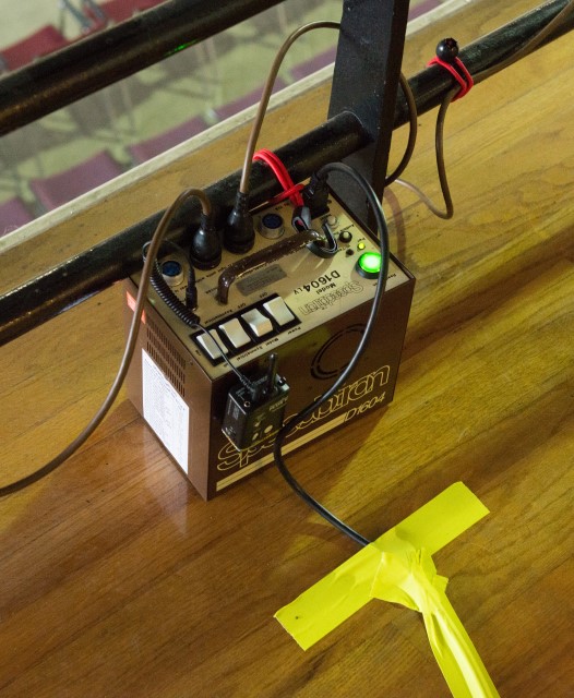

This balcony area was open to the public, and while it wasn't expected to be used much, if at all, I didn't want to take any chances. Here you can see my cables ball-bungeed to the railing, the power cord is gaf-taped down, and the power supply has a safety cord (it's too tall to fit under the railing):

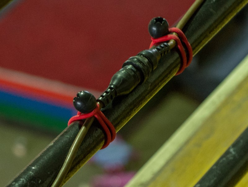

Ball bungees keeping the extension cord secure and out of the way:
As an added precaution, the handles on the magic clamps were also gaf-taped to prevent idle twiddling:

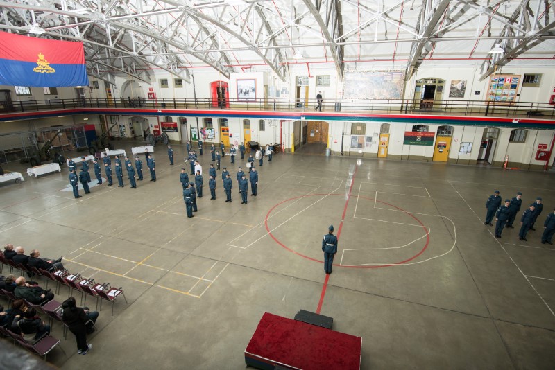

Here's a partial view of the space; you can see the hot spot from the light, but as I wasn't shooting on the balcony, I wasn't concerned; the idea was to get an even, flat light on the floor to produce the best overall photos:
The goal was to get sufficient light to allow me to shoot sync speed (1/250) at f5.6 <ISO 800. The general results looked something like this:
Not bad for a space lit with metal-halide arc lights and a few gable windows. Base exposure without flash was ISO 1600, 1/25, f2.8.
