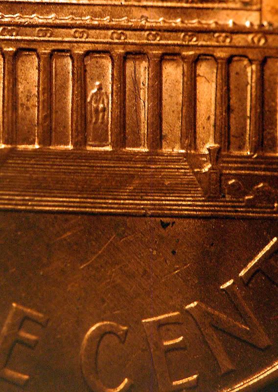

put on my newly made creation and.
heres a 100% crop of that pic
another shot
and crop
and one more.
works alright for something i just made for free.

works well on my old kodak P&S camera as well.(can actually focus closer than those D50 pics are)
but the battery died on me. so no pics for now.

if you dont have a dslr,
heres a shot with it on my old 4mp kodak easyshare camera.
this isnt cropped at all. just 20% resized.
