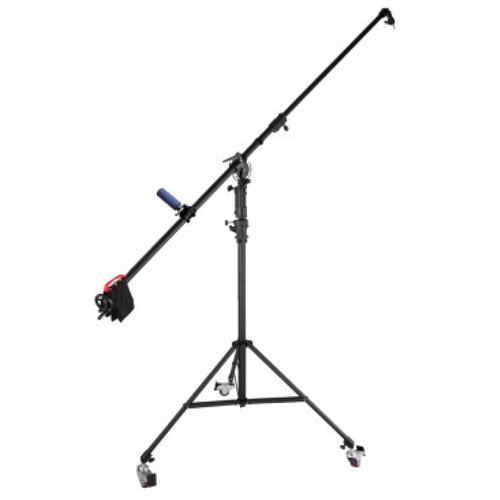

I have been browsing for a boom light stand that fits my Flashpoint monolight. I see some are detachable arm. Can anyone steers me to the right direction? I'm not sure which one I should buy.
Something like this: Manfrotto 085BS Heavy-Duty Boom and Stand (Black) 085BS B&H
That is one of the problems with buying monolights instead of pack lights, they are much heavier requiring much heavier stands, especially for boom arms.
I have two of the above rolling boom stands, with 15.5 lb. counterweights: VERY rugged, sturdy. OIne from 1986, the other from 2007, both have held up well. Strong and heavy enough to use as a background papper roll support on the boom arm, with the heavy counterweight added. Handles heavy lights. BUT---the above might be bigger and heavier than you really need. SOmething like a Kupo or Avenger "C-stand" and a three or four foot boom arm and a five pouind counterweight might be what you want? Not sure what you want the boom for: there are light, heavy, and medium-duty boom arms available, but the C-stand and short arm "might" be all you need. For example--do you really NEED the boom stand to have rolling wheels?

In your part of the world there should not be too much of a problem looking around for a good used boom stand. The one I have is overkill, with twin adjustment wheels, one to raise and lower the arm and one to adjust the head. I got it for a song used. Less than the boom I linked to. Very similar to this but not near as pretty since it was used.
