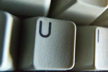

This is the sort of thing I usually shoot with a 50 mm lens and extension tubes, though I think this was shot with a wide angle lens and extension tubes. It is the sort of subject that is good for 50 mm and extension tubes because the keyboard is not afraid of me, or the camera. Rice, dimes and batteries are other great sources of amusement for that combination. Since they bite, leave, or both, bugs and small reptiles are not great subjects for a short macro arrangement.

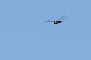

This is done with a regular telephoto lens. If you are ever bored, try shooting dragonflies while they are hunting for food. It will change boredom to frustration fairly quickly.
