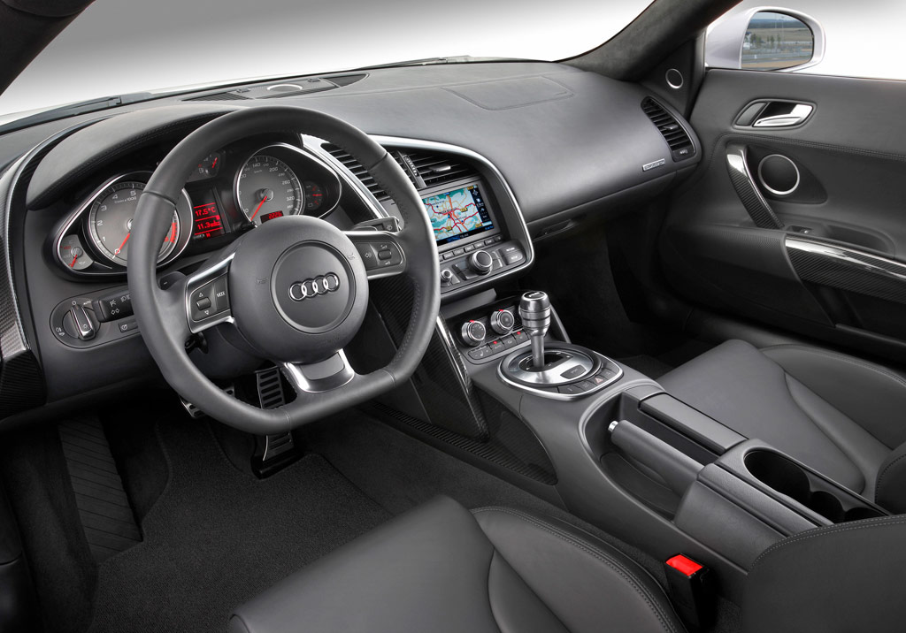

As you can see, the engine is rear mounted and visible by way of a glass hinged cover that lifts up. There is also a window in the engine bay that allows you to view the interior of the car.
http://www.carbodydesign.com/archive/2006/10/03-audi-r8/Audi-R8-interior-1-lg.jpg
Now what I am hoping to do for a unique angle on this car is light both the engine bay, and interior, to produce a shot like this:

In terms of setup I was thinking of working with a longer lens to get the desired angle mounted on a tripod, and lighting the engine bay with one light source directly from above, and having 2 shoot through umbrellas in each open door to light the interior.
I'm trying to think of the best way to do this with the equipment I have; I've currently got 1 40" umbrella and one 50" umbrella both reversible. Picking up another one is not the end of the world.
Do you think a softbox would be better to produce even light across the engine back, or would a umbrella work okay?
Would it maybe be better to have a shower curtain above the engine bay and shoot a light down into that to really diffuse the light and make it nice and soft?
I notice I will have to remove the headrests from the seats to give the unobstructed view of the interior from the rear, angle the mirror so it doesn't pick up any of the lights, and likely put a white sheet across the windshield to reflect any light back into the interior to light the back portions of the dash.
As far as gelling flashes, I was thinking something cool in the engine bay, with a warming gel in the interior just to contrast the 2 zones.
I've also got a concern about reflections off the glass partition between the interior and engine bay, and how do i deal with that.
One thought was to possibly layer things in CS3, but i've never actually done that. Because its all set up on a tripod I could create like 2 seperate zones and focus first on lighting the engine bay properly, and then on lighting the interior properly and merging the two together somehow. It would be easier, and nicer if I could do it all in one go.
I'll likely have the car for 3 or so hours, but it will need to be detailed which will take a large portion of the time. I've worked through a lot of the lighting already, just trying to get some more insight into what might work better that I haven't already thought of. I'd like to have everything planned out before I arrive so i'm not wasting time trying to map things out from scratch.
