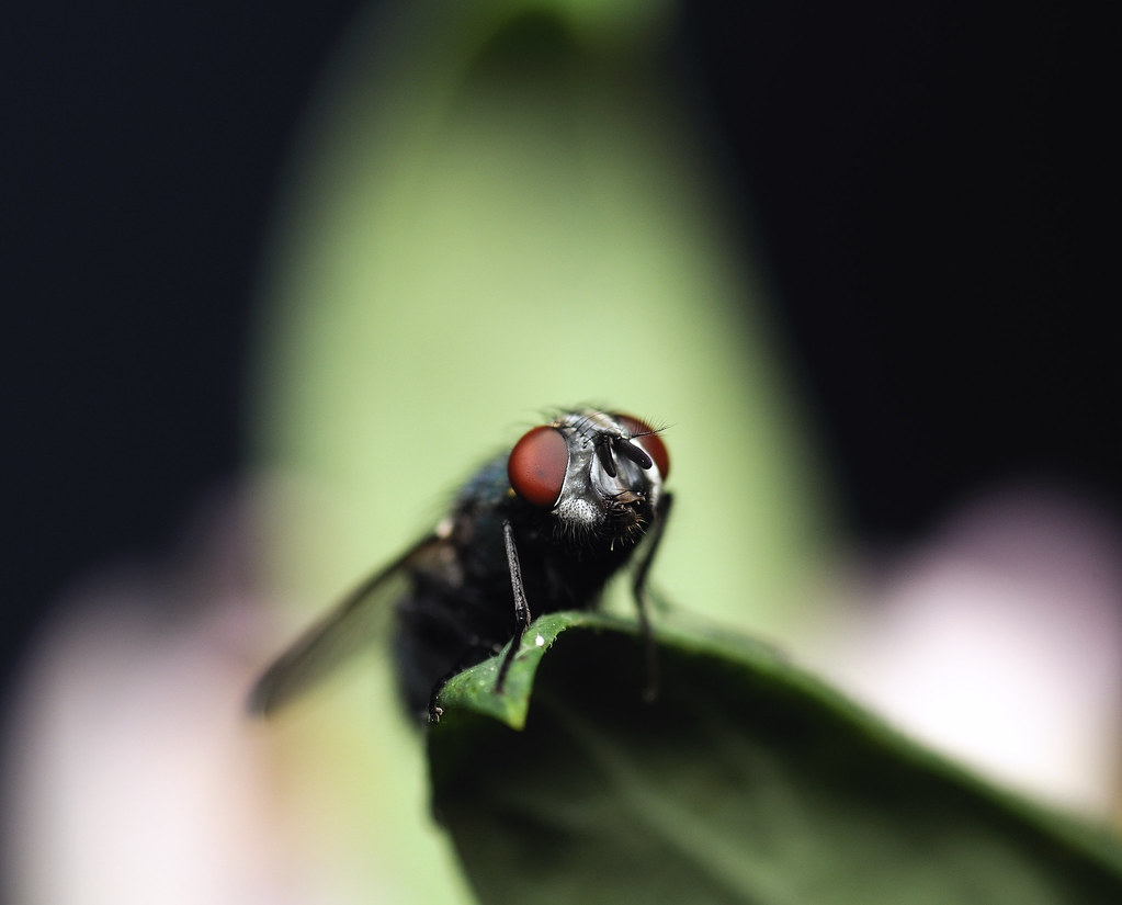

Pretty sure I didn't crop this; taken with the Tokina 100mm macro Charlie mentioned--it's my favorite lens (okay, granted, I only *have* four lenses, and one is the 18-55 kit lens, but still...).
I do also have a set of Kenko extension tubes, so I could get closer if I wanted, and if the bug wanted to cooperate. :D
stink_0020web by sm4him, on Flickr
Oh, also, if I remember, I wasn't even as close as I could get with just the macro on this. I wanted the entire bug in the shot, so I backed up a good bit.

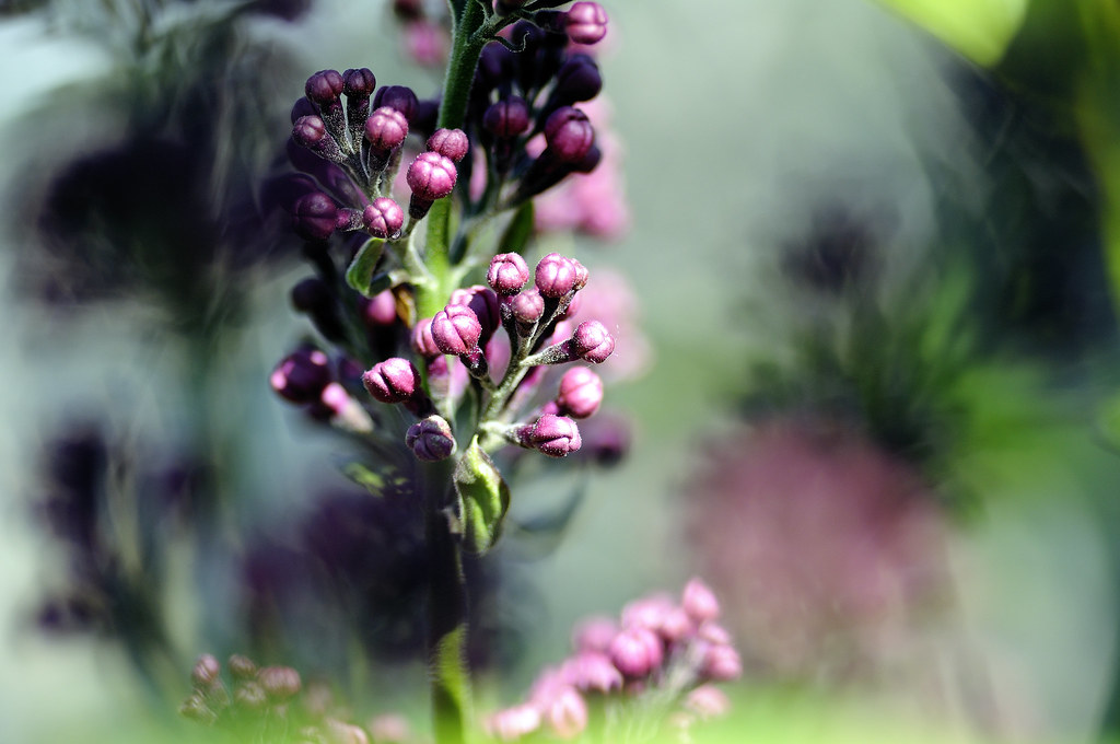

This one is also uncropped (actually, I *may* have cropped it a very small amount), and is probably at the closest focusing distance with just the Tokina. Again, I could have put one of the extension tubes with it, but then I'd have been focusing with the lens pretty much ON the flower! :lol:
passionflower_0057 by sm4him, on Flickr
