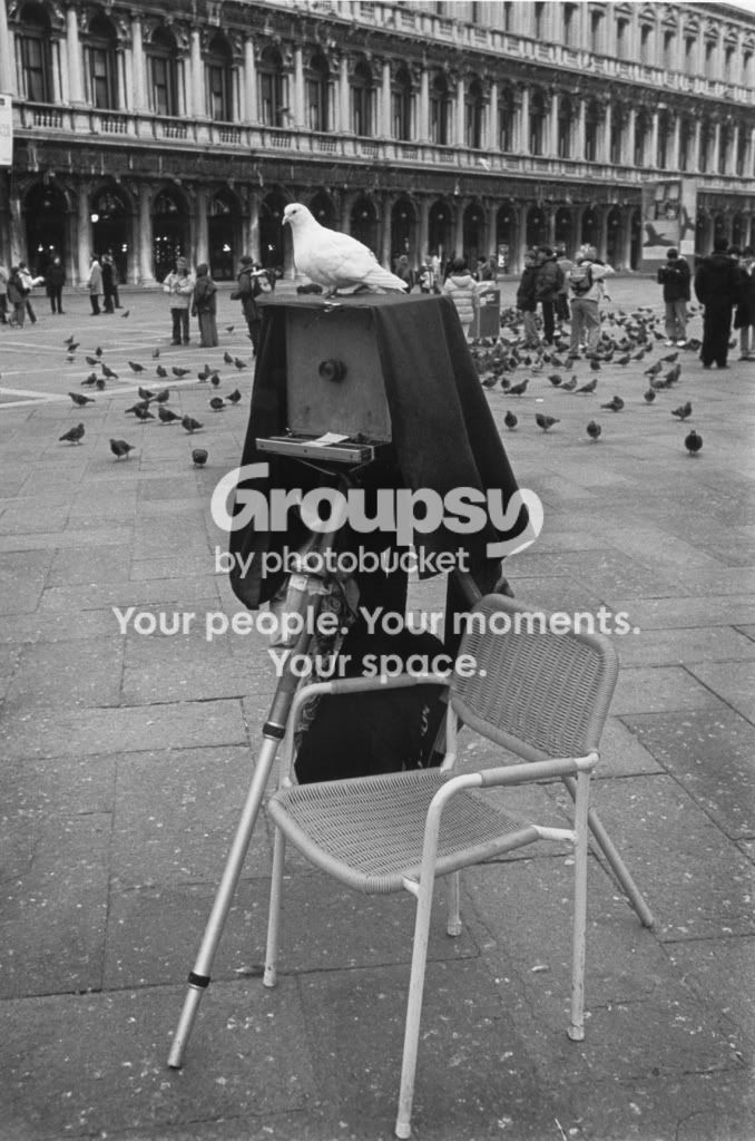

Another advantage of LF...BIG cameras attract the birds too :D
