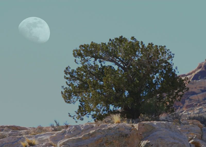

Here is a quick example of a composite moon/tree:
Larry, is your example just two separate photos combined in photoshop?
it looks very realistic. how did you do this?
