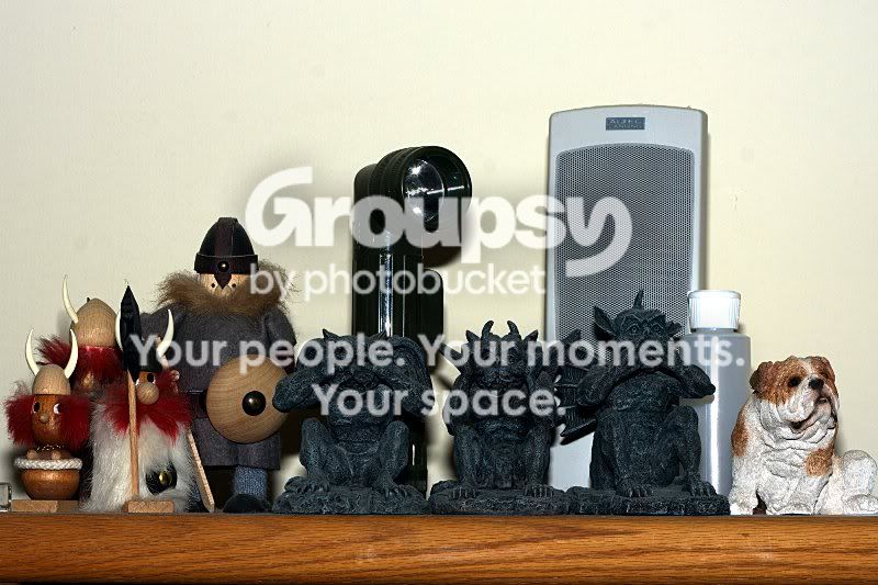

Just as a proof of concept I tried this with my camera. I turned off all of the lights except for an aquarium across the room. Just enough to allow focus. I turned down the power on my 285HV (very bright at full power, but certainly not as bright as your SB600 can go if I turn it down to 1/4). Dropped all the way down to ISO 100 and max flash sync speed of 1/250. Aperture came in at f/11.
Just a bad photo of some assorted junk on top of my desk taken in the dark.
I can't speak to the white balance issues at all but your exposures are telling me that you're just not getting light onto your subject.
I just don't get it.
How is it you are shooting at 1/15, ISO 800 and aperture of f5.6, and you're using flash and you're STILL not getting enough light?

Last night I was asked to duplicate the shot in P mode, but I didn't. I had my 18-55 mounted and no lightsphere. Well, this morning I duplicated the shot, but I did it in AUTO just to make sure that it's something that I'm doing wrong. And it is... So I really appreciate your guys' patience and sorting this out. I need to find out what settings are wrong. Here's the results with 70-300 mounted, SB600 mounted in TTL mode and Lightsphere mounted, camera in AUTO. I think these are perfect color-wise and exposure-wise, so I don't really have any reason to leave Auto mode. The only reason I want to learn how to shoot in Manual is because of the Quantarays/umbrella setup for doing portraits. They don't fire at the right time in Auto due to being optically triggered. Anyway-here's the results from this morning in Auto:
So I don't think there's anything wrong with my camera-just my skills..
