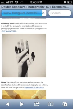

I'm on the same page but how is this done

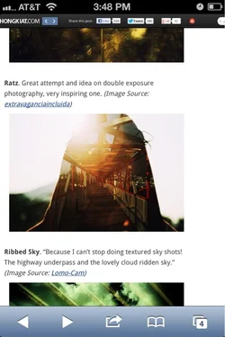

Or this, if its in PS, I'm all set but in camera how do you get these clean cuts n mask. This is where I'm lost.
