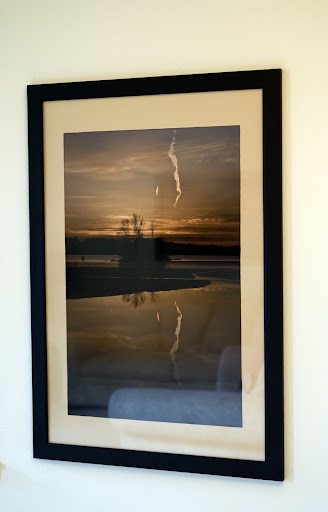

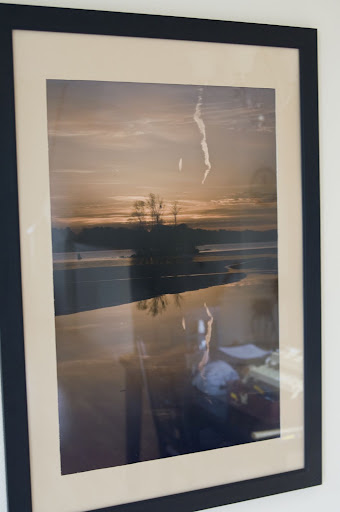

Well, I ventured into new places and matted my 1st photo ever. Overall I think it was a god job for the 1st time. I didn't have a matt cutter, so I used exacto knives. Next time, I will have a matt cutter.
Here are a couple photos of it. The photo is a 20x30 in a 24x36 frame.
Sorry, impossible to tell what kind of job you did from those photos. But cutting a mat is not that hard... with the right gear. I wouldn't want to be doing it with an Xacto knife though.

I buy the nonflective glass. Cant really tell because I can see your living room in the glass.
